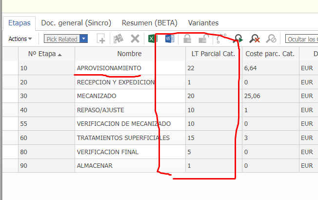

Hello colleagues, I have a problem. I'm trying to do a SQL, select sum(.....). The code doesn't give me an error, but I don't know how to access the value of the variable later.
If you see my code, I have assigned a name to the value received, but when I execute the code, it always gives me "0", which is the value I have entered if there is nothing.
[embed:dc8ab71f-3b98-42d9-b0f6-e21e02a0f8e2:cf66ea03-c953-4381-876e-bad88390f9e3:type=csharp&text=Innovator%20innovator%20%3D%20this.getInnovator%28%29%3B%0A%0A%2F%2F%20var%20innovator%20%3D%20new%20Innovator%28%29%3B%0A%0Astring%20ID%20%3D%20this.getID%28%29%3B%0A%0A%2F%2F%20esto%20sumaria%20todas%20las%20etapas%0Avar%20SentenciaSql%20%3D%20%22%20select%20sum%28MT_R_RUT_ETA.mt_rp_rut_eta_ltime%29%20as%20%27Resultado%27%22%2B%0A%22%20from%20innovator.MT_RUTA%20%22%2B%0A%22%20join%20innovator.MT_R_RUT_ETA%20on%20MT_RUTA.id%20%3D%20MT_R_RUT_ETA.SOURCE_ID%20%22%2B%0A%22%20where%20MT_RUTA.id%20%3D%20%27%22%2BID%2B%22%27%22%3B%0A%0Avar%20ResultadoSQL%20%3D%20innovator.applySQL%28SentenciaSql%29%3B%0A%0A%2F%2F%20tomamos%20el%20valor%20de%20la%20suma%0Avar%20LT_Tot%20%3D%20ResultadoSQL.getProperty%28%22Resultado%22%2C%220%22%29%3B%0A%0A%2F%2F%20esto%20sumaria%20todas%20las%20etapas%20MENOS%20APROVISIONAMIENTO%0ASentenciaSql%20%3D%20%22%20select%20sum%28MT_R_RUT_ETA.mt_rp_rut_eta_ltime%29%20as%20%27Resultado%27%22%2B%0A%22%20from%20innovator.MT_RUTA%20%22%2B%0A%22%20join%20innovator.MT_R_RUT_ETA%20on%20MT_RUTA.id%20%3D%20MT_R_RUT_ETA.SOURCE_ID%20%22%2B%0A%22%20where%20MT_RUTA.id%20%3D%20%27%22%2BID%2B%22%27%20and%20MT_R_RUT_ETA.KEYED_NAME%20not%20like%20%27APROV%25%27%22%3B%0A%0AResultadoSQL%20%3D%20innovator.applySQL%28SentenciaSql%29%3B%0A%0A%2F%2F%20tomamos%20el%20valor%20de%20la%20suma%0Avar%20LT_Par%20%3D%20ResultadoSQL.getProperty%28%22Resultado%22%2C%220%22%29%3B%0A%0A%2F%2FString%20s%20%3D%20LT_Tot.ToString%28%29%20%2B%20%22%20-%20%22%20%2B%20LT_Par.ToString%28%29%3B%0AString%20s%20%3D%20ResultadoSQL.ToString%28%29%3B%0Areturn%20innovator.newError%28s%29%3B]
I do it using SQL because it is faster than creating an AML and going through it to add the values.
1.- There is something similar in AML to "select sum"
2.- How can I pass the value of "SQLResult" to a variable to be able to display it on the screen.

    glad to see you haven´t given up yet! :)
    Normally SQL is executed form server Method. Does your version really work from a client Method?
    One issue that I notice are these two lines:
    ResultadoSQL = innovator.applySQL(SentenciaSql);
    // tomamos el valor de la suma
    var LT_Par = ResultadoSQL.getProperty("Resultado","0");
    You execute the SQL, but than immediately want to read a column of the result. But you haven´t got the result item itself yet. applySQL can return multiple items!
    Try something like this
    Item sqlItem = ResultadoSQL.getItemByIndex(0).getProperty("Resultado","0");
    To my knowledge there is no inbuilt option to make "SUM". You can replicate "Count", but for other stuff you would need a custom Method, like described here:  link
    But for your use case (updating multiple very specific relationships), using SQL is ok.
  • Ok, I have passed the code to Javascript and used the debugger.
    The problem is that I called it "Resultado", but when I execute the SQL it returns as "resultado".

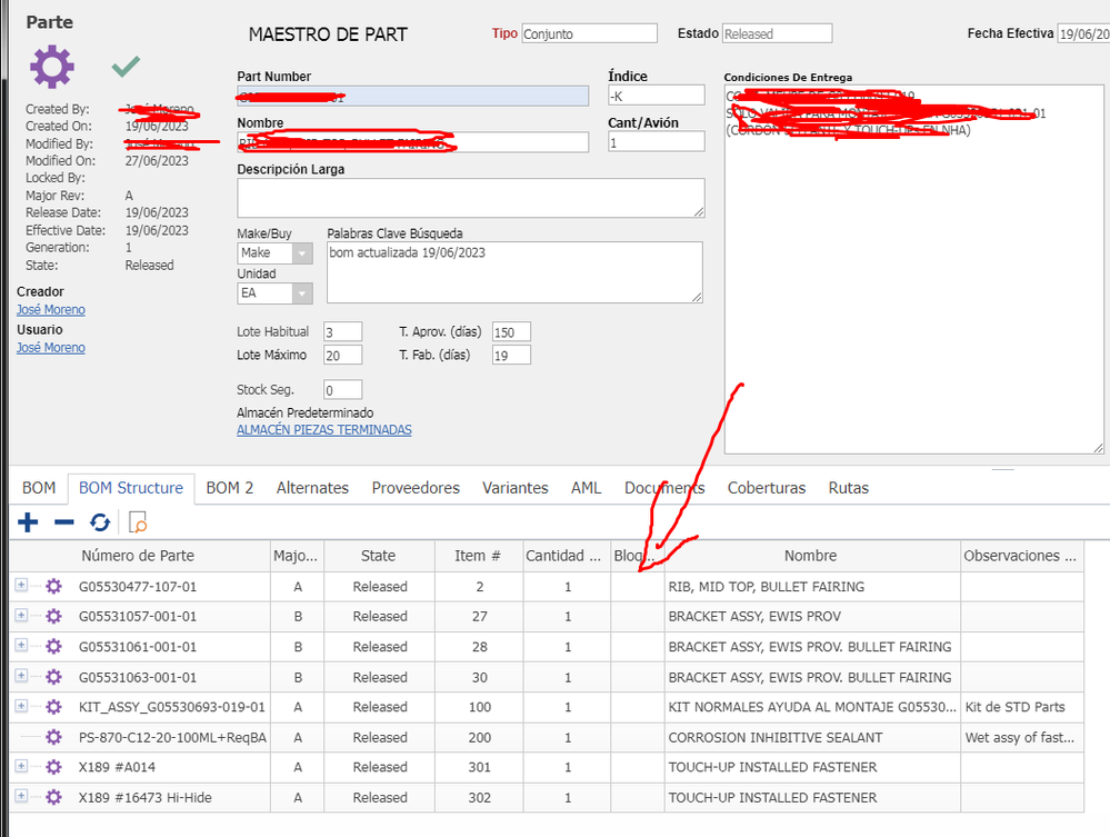

        ha ha ha. Never surrender!!!. Only I already suffer it in silence!! hehehe. What I've been doing lately, I more or less control it!! Although I have some "polstergeists" that I can't figure out why.
        But yes, sometimes it makes me want to run away!! :).
        The problem was that although I had written in the SQL to return the value as "Result", in the getProperty it had to say "result", all in lowercase, I don't know why. In SQL Server, it returns the field name as I define it: "Result".
        Thanks for the link!!, I searched with a magnifying glass, but I didn't find anything. or broken links.
        I have some questions, I'll post them in the forum...... :)
        I have in hand to modify the "PE_GetMultilBom" method. I made a first attempt, but it doesn't show me the value on the screen. I'll put a post in the forum asking for help, hehe.
