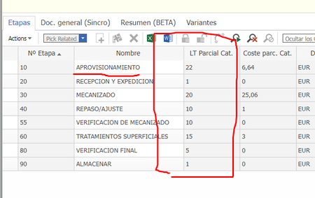

C# - applySQL. "Select sum()......"
Hello colleagues, I have a problem. I'm trying to do a SQL, select sum(.....). The code doesn't give me an error, but I don't know how to access the value of the variable later. If you see my code,...
