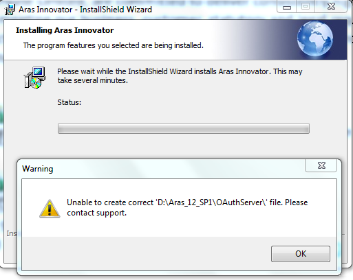

While installing Aras 12 I'm getting below error
If I clicked on Ok aras installing but I'm not able to do login.

  • Hi Suhas,
    Check if you have the following then reinstall Innovator:
    1. Make sure you have the correct .net core and asp.net core installed (2.1.8)
    2. Check your environment variables to ensure that system path variable points to the installed .net
    Best,
    Nithin

      Hello Nithin,
      Thanks for your quick response.
      I have checked all configuration and configuration is correct.

        Hi Suhas,
        No problem! If you click ok and then try to start innovator does it bring you to a blank screen with an error stating the OAuth server config file is missing? Another thing you can check is if your system Path variable also points to powershell.
        Best,
        Nithin
