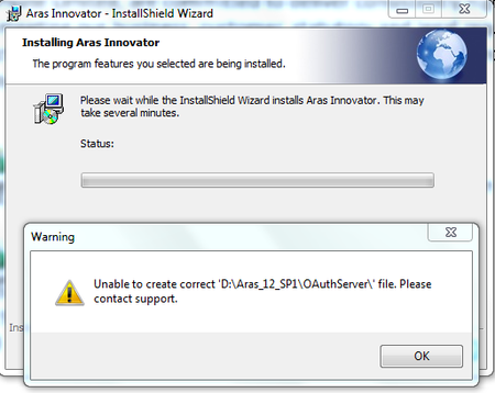

Hi Suhas,
Check if you have the following then reinstall Innovator:
1. Make sure you have the correct .net core and asp.net core installed (2.1.8)
2. Check your environment variables to ensure that system path variable points to the installed .net
Best,
Nithin
- Suhas6 years agoCreator III
Hello Nithin,
Thanks for your quick response.
I have checked all configuration and configuration is correct.
Regards,
Suhas
- Nithin_Mahesh6 years agoCreator II
Hi Suhas,
No problem! If you click ok and then try to start innovator does it bring you to a blank screen with an error stating the OAuth server config file is missing? Another thing you can check is if your system Path variable also points to powershell.
Best,
Nithin
Hi Nithin,
Yes, if I clicked on Ok button and then try to start innovator it is showing blank page.
How to check system path variable?
Regards,
Suhas
