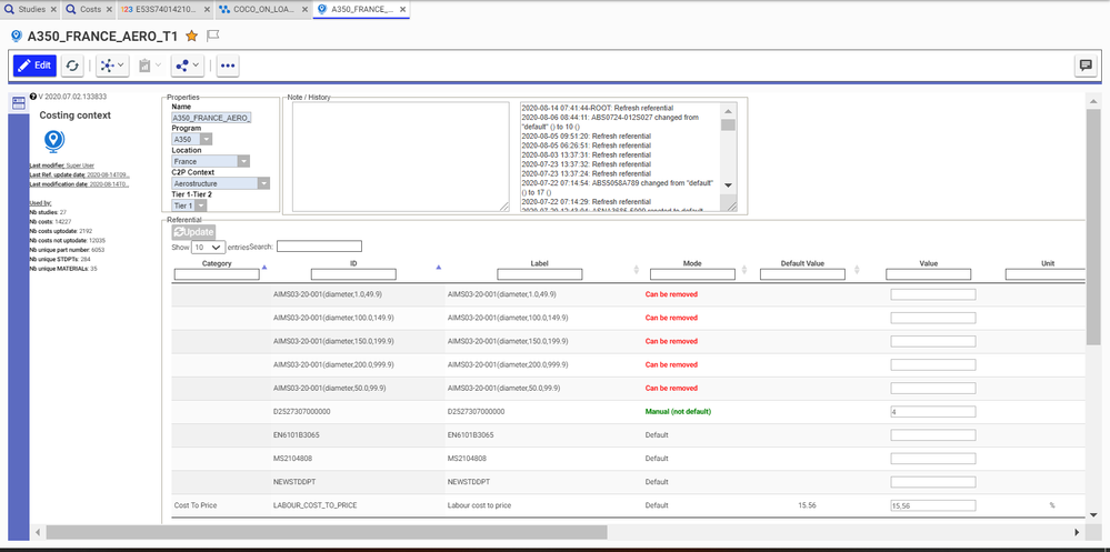

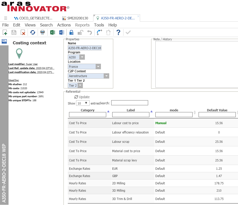

For an ItemType without relationship,  ARAS 11 lets all the available place for the display of the item.
See my ItemType in ARAS 11:

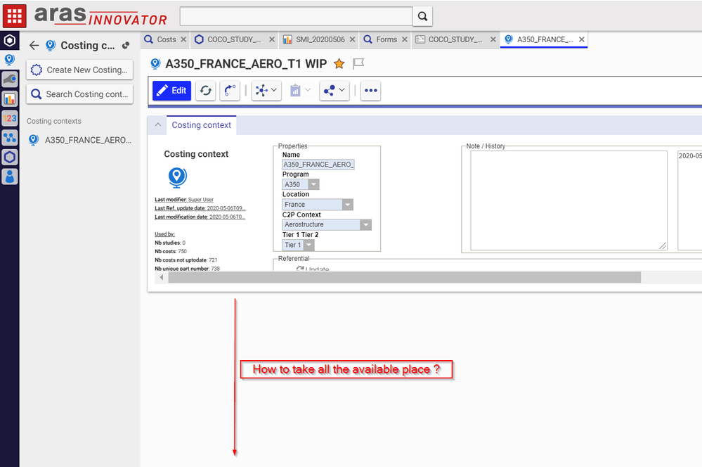

But with ARAS 12, this is not the case.
See the same ItemType in ARAS 12:
Is there a solution to force the "Costing Context" to take all the place or to remove this frame ?

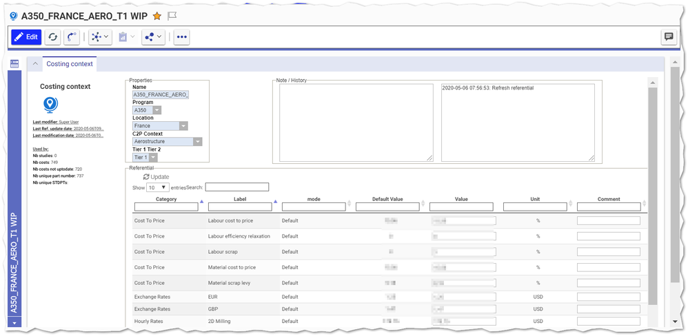

    • At the end the result is much more better:
    • As you can see the accordion has been removed and all the available place is used

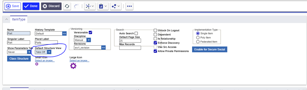

    Hello ,
    You can removed relationships tab with the help of configuration. So you can use complete screen for Source item.
    You can do Tabs Off in "Default Structure View" property on your item type.
    Please find the below screenshot to disable relationships tab.
    Regards,
    Suhas

      Hello Suhas,
      Thank you for your answer.
      I already have the property on "Tabs Off".
