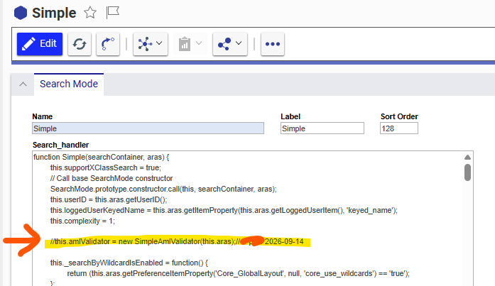

I did some testing today with Chrome Canary.
There is a flag that can be used to keep XSLT support available for another year. This at least ensures that users can log in, but Innovator will still be largely unusable.
Reason: Search Modes. We will need to patch all Search Modes as well. This is not an issue for I14, but it does affect I12 and I11!!!
I ran some initial tests and was able to restore the "Simple" search mode in I12, which provides a basic level of usability. However, all Search Modes will need to be reviewed and customized to fully address the issue.
Try it by yourself. Download Chrome Canary and tell me what you see!
If in your test the grid doesn´t work, try this one. Remove the amlValidator from Simple SearchMode. It´s not a finished solution, but at least confirms that we have to update the SearchModes as well.
I am still working on an XSLT patch itself, using the XSLT flag is a workaround that gives us more time.- patricia_baxter_matrix_co_nz1 month agoIdeator I
