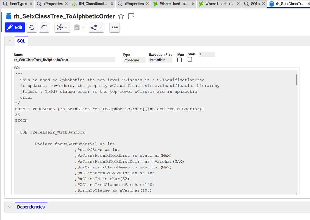

I have written a SQL Query, Stored Procedure, to Order an xClassTree so that the top level xClasses are in the alphabetical order.
If I run the query just as a SQL query, in SSMS, it works great.
If i run the query as a Stored Procedure in SSMS, created using the innovator SQL itemtype, it works great.

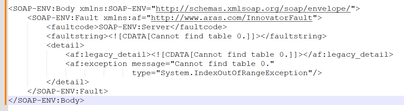

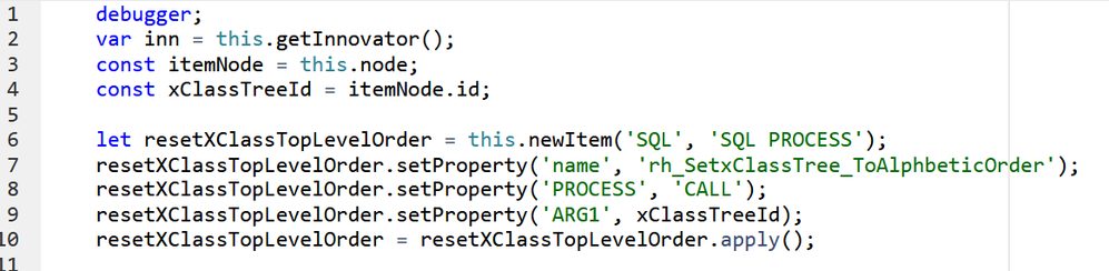

If I try and run it from a javascript method it does not work and generates a SOAP message.
The javascript code uses the following to trigger the run.
In the debugger see the following in resetXClassTopLevelOrder Item, under DOM:XMLDocument, after .apply()

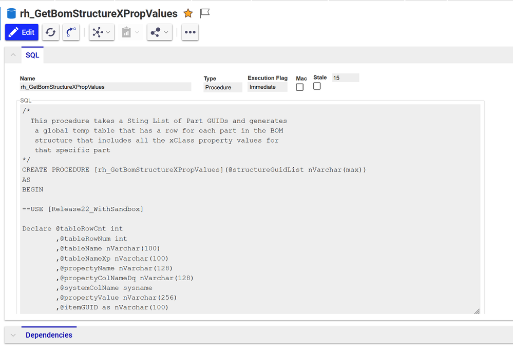

    • Hello Angela,
      Yes I think so. Here is a snapshot.
      Actually this is my second use of this capability.
      The first one was the SQL Procedure I created to collect all the xProperty data for a single End Item structure and it works great and both are run from the Client Side.
