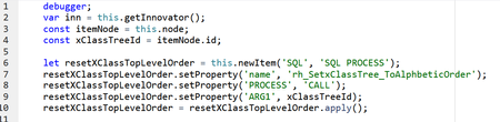

I assume you tested your SQL code in SSMS and then created a new SQL item in Aras. Have you set the "Immediate" Flag and the correct type?
What right now completely confuses me: Since when it is possible to call SQL procedures from Client side? I made a quick test and it indeed works. But I never thought this would be possible. According to my knowledge. SQL is always called from server Method - never from Client side.
Does anyone know more?
- srmorrisonearthlink-net2 years agoCreator I
Hello Angela,
Yes I think so. Here is a snapshot.
Actually this is my second use of this capability.
The first one was the SQL Procedure I created to collect all the xProperty data for a single End Item structure and it works great and both are run from the Client Side.
