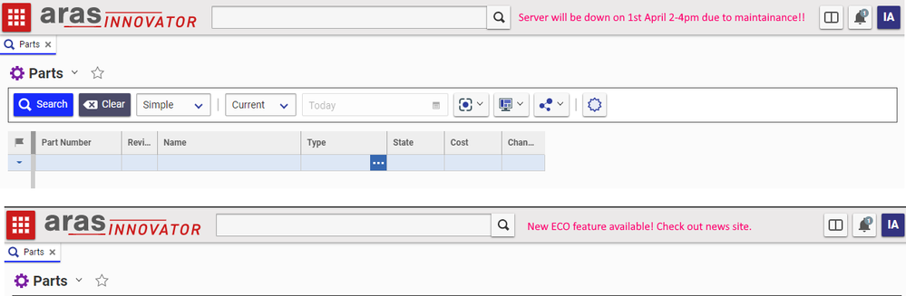

I wonder if we can display important notifications at a more prominent position. Something like this:
Right now it would be possible to use CUI to create this kind of messages similar to this database indicator community project:
https://community.aras.com/f/development/6610/how-to-display-database-name-on-bottom-in-innovator-12
https://github.com/ArasLabs/database-name-in-header
Fun fact: The database indicator is now on the roadmap (and it makes me proud that I was the first to ask for it :) ) . I 100% can recommend the project as it´s improves productivity by 1000%.
The CUI approach for Notifications has one disadvantage. In contrary to the database indicator, the text is not static. We always would have to update the used Method. It would be more elegant if we can use the standard Notification ItemType (with expiration dates and target identities) but then specify an alternative display location (Standard, Popup, Main Window Header).
But maybe any of you know a complete difference approach to this use case? I don´t think it´s hard to achieve, I just want to have a solution that is easy to use for admins.

  • I solved this one with a simple workaround in combination with the database header project.
    It turned out that Innovator "Variables" can store an insane amount of text inside the "value" property. More then enough to store a single line of informative text for the main window header. As Variables are easy to customize for admins these do the job well until there is a better variant.
    It´s possible to look up for Notifications items incl. date and target identities the same way, but Variables are a cheap option.

      I so far us the pop up mostly. They do the job well most of the time. But sometimes people click them away or the browser blocks the popup.
      And I just like the idea of using the main header or some kind of 'news site' inside innovator to keep people up to date. Maybe a simple news site would even be a better and simpler approach.
      The current notifications are build with a mix of Core, CUI and Codetree elements.
      It´s maybe possible to add a custom CUI element and reuse the code from the "Standard" Notification mode. Maybe 10 lines of codetree modification needed, but doesn´t seem impossible.
      It´s something to test on a rainy summer day.  Not really important, but useful once it´s there.
