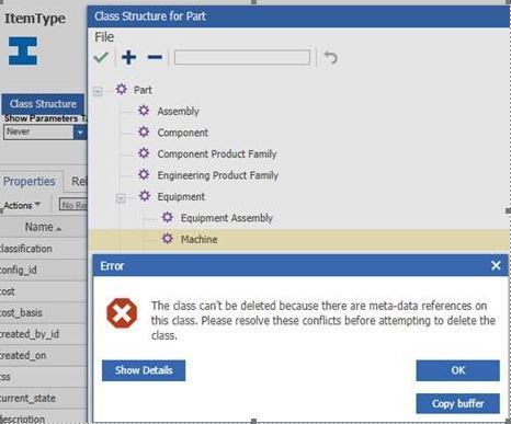

Hi Aras community,
Would you please help one thing?
In Part ItemType, I tried to delete 'Machine' from 'Class Structure for Part'.
We have couple of parts which have 'Machine' Classification.
So, I updated 'Machine' in Classification field in part table in database with 'new classification'.
And then, I tried to delete 'Machine' from 'Class Structure for Part'.
However, system shows the error message below:
Is there a way of deleting 'meta-data references' on this class?
Thank you so much for your help in advance.
Regards,
Joseph

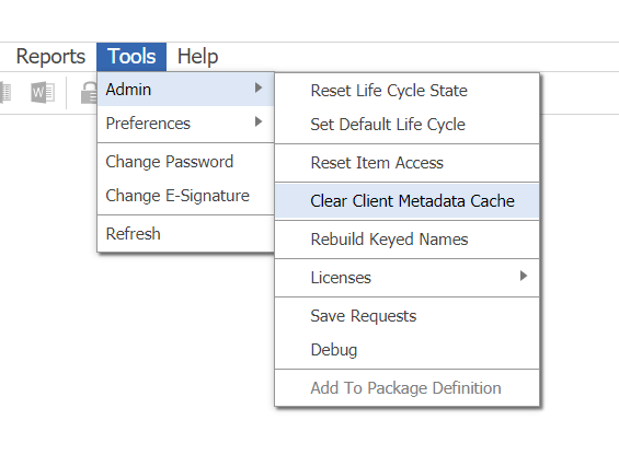

  • Hi Joseph
    I'm able to delete the classification in my local instance without any issue. Not sure whether below solution will work or not. But worth giving a try
    Step 1: Tools > Admin > Clear Client Metadata Cache
    Step 2: Log Out
    Step 3: Clear browser cache
    Step 4: Restart IIS
    Step 5: Re-login to ARAS and try deleting the subclass
    Thank You
    Gopikrishnan R
