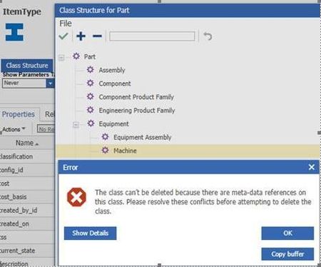

Hi Joseph
I'm able to delete the classification in my local instance without any issue. Not sure whether below solution will work or not. But worth giving a try
Step 1: Tools > Admin > Clear Client Metadata Cache
Step 2: Log Out
Step 3: Clear browser cache
Step 4: Restart IIS
Step 5: Re-login to ARAS and try deleting the subclass
Thank You
Gopikrishnan R
