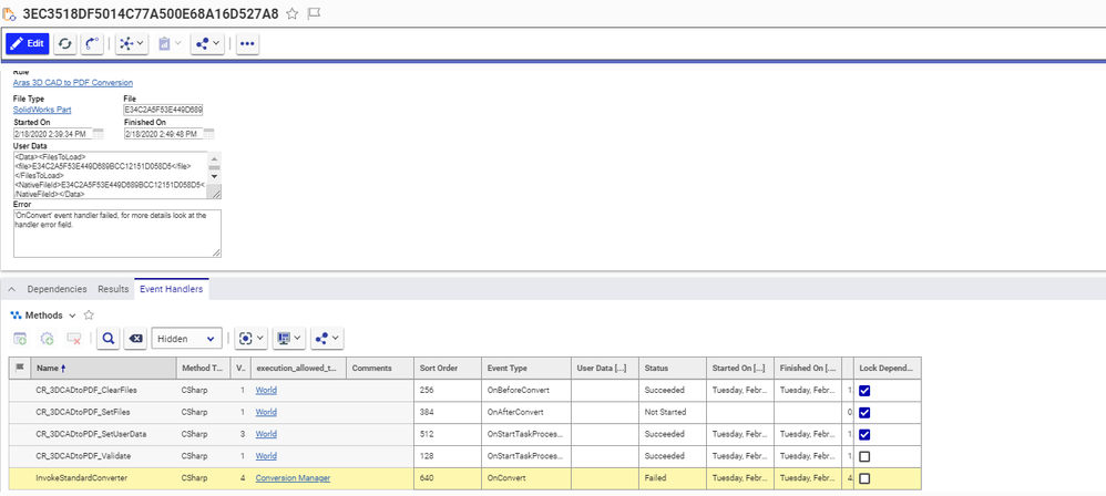

3D CAD to PDF Conversion Task failed.
      I am trying 3D CAD to PDF conversion in aras innovator 12.
Conversion task is failing with error message as "'OnConvert' event handler failed, for more details look at the handler error field."
It look like conversion task is failing for 'OnConvert' Event which call 'InvokeStandardConvertor' method.
Someone Please help me out, Why Conversion Task is failing?
Also getting this error message in CONVERSIONTASKHANDLERERROR
Aras.ConversionFramework.Exceptions.ItemErrorException: Line number 15, Error Number: CS1002, ; expected
Line number 15, Error Number: CS1513, } expected
at Aras.ConversionFramework.Models.DAL.ItemContext.AssertItem(Item item) in C:\Builds\CI\15974\Innovator.git\CompilableCode\ConversionFramework\ConversionManager\Models\DAL\ItemContext.cs:line 120
at Aras.ConversionFramework.Models.ConversionTaskEventHandler.Execute(ConversionTask task) in C:\Builds\CI\15974\Innovator.git\CompilableCode\ConversionFramework\ConversionManager\Models\ConversionTaskEventHandler.cs:line 220
at Aras.ConversionFramework.Models.ConversionTask.ExecuteEventHandlers(ConversionTaskEventType eventType) in C:\Builds\CI\15974\Innovator.git\CompilableCode\ConversionFramework\ConversionManager\Models\ConversionTask.cs:line 349

  • Anyone has resolution on this issue, as I am getting similar error with Aras 12 on one Test server
    • Nilesh's avatar
      Nilesh
      Hi Devidas,
      I resolve it by providing full control of ConversionServer folder in installtion directory.
      Thanks,
      Nilesh
      • dkahraman's avatar
        dkahraman
        Hi Nilesh,
        did you provide full control to IIS_IUSRS user?
        Duygu
