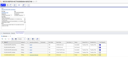

NileshCreator I6 years ago3D CAD to PDF Conversion Task failed. Hello, I am trying 3D CAD to PDF conversion in aras innovator 12. Conversion task is failing with error message as "'OnConvert' event handler failed, for more details look at the handler er...Show More
DevidasIdeator I6 years agoAnyone has resolution on this issue, as I am getting similar error with Aras 12 on one Test server
NileshCreator I to Devidas6 years agoHi Devidas, I resolve it by providing full control of ConversionServer folder in installtion directory. Thanks, NileshdkahramanCreator I to Nilesh6 years agoHi Nilesh, did you provide full control to IIS_IUSRS user? Duygu
