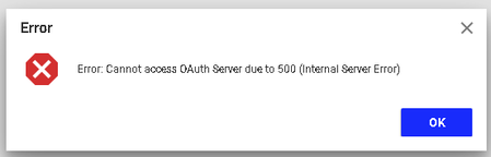

I tried to uninstall all of the updates, but Windows would not let me uninstall the .NET update.
A week later IT automatically reinstalled the the updates I uninstalled. There is no going back.
Server is useless now, Aras doesn't work. Can't demo it to management.
I can't believe support won't help at all, we can't be the only ones who keep our servers up to date. No response for 26 days now.
Hi Bryan,
.NET 4.7.2 should not be necessary. I was not able to install it at all during my last two Aras server setups, cause I already had newer versions installed. And finally turned out that it was not needed at all, so I simply started to ignore this requirement.
Error 500 is caused by missing 2.1.8 hosting bundle. That´s nothing new of course. But you really have to choose the correct installer. I cover this one in my video around minute 9:21: https://www.youtube.com/watch?v=A5QEtOO86ik
Hope it will work for you as well!
- Bryan5 years agoIdeator II
I was able to resolve this issue by installing the .NET 4.7.2 Developer Kit, Uninstalling and Reinstalling Completely. Repair install did not work.
- angela5 years agoCatalyst II
Thanks for the hint! interesting that in your case it was necessary to use .NET 4.7.2. Maybe there is some dependency with IIS settings, so in some setups it´s required, in others not.
