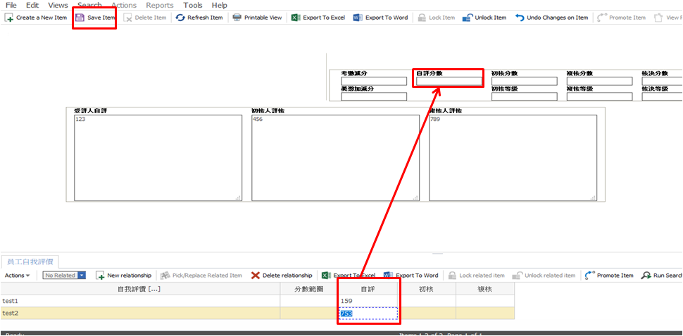

I have an item type and a relationship
I want to calculate the sum of one of the columns of the relationship when the user presses the save button
and update it to the parent item.
If I put the method in the onafterupdate of the parent item, it will do an infinite loop
If I put the method in the onafterupdate of the relationship, when I update the value of more than one relationship, it will prompt me that 「Aras.Server.Core.ItemIsNotLockedException」...

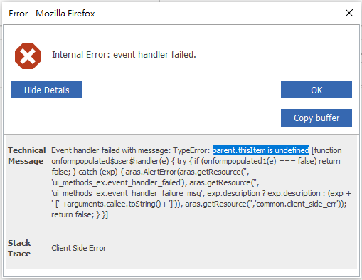

      hi ,Gopikrishnan
        First of all, thank you for your reply!

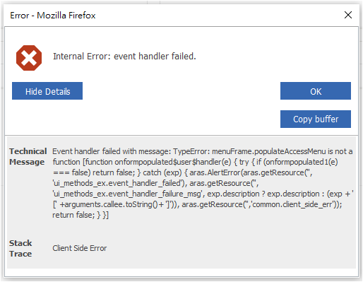

        I tested this code, but I get the error message "parent.thisItem is undefined" or "menuFrame.populateAccessMenu is not a function".
        Later I changed the
        aras.uiReShowItem(parent.thisItem.getID(), parent.thisItem.getID());
        changed to
        "aras.uiReShowItem(document.thisItem.getProperty("id"), document.thisItem.getProperty("id"));
        There is still the error message "menuFrame.populateAccessMenu is not a function"...

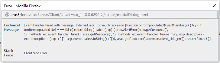

        And it also seems to cause infinite loops when placed under this event
