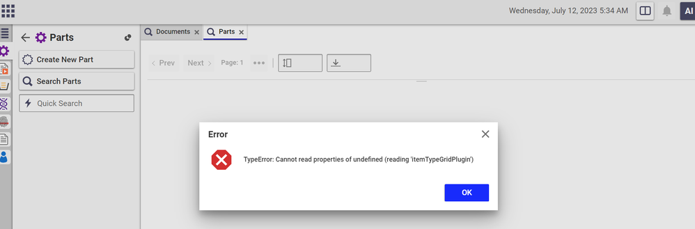

TypeError: Cannot read properties of undefined (reading 'itemTypeGridPlugin')
Dear team,
We are currently using Aras version Release19. However, when attempting to perform searches for both parts and documents, we encounter an error stating "TypeError: Cannot read properties of undefined (reading 'itemTypeGridPlugin')." This error is causing the search operation to fail. Could you please advise on how to resolve this issue? I have already checked the error log, but I couldn't find any relevant information.
Attaching screenshot for your reference.

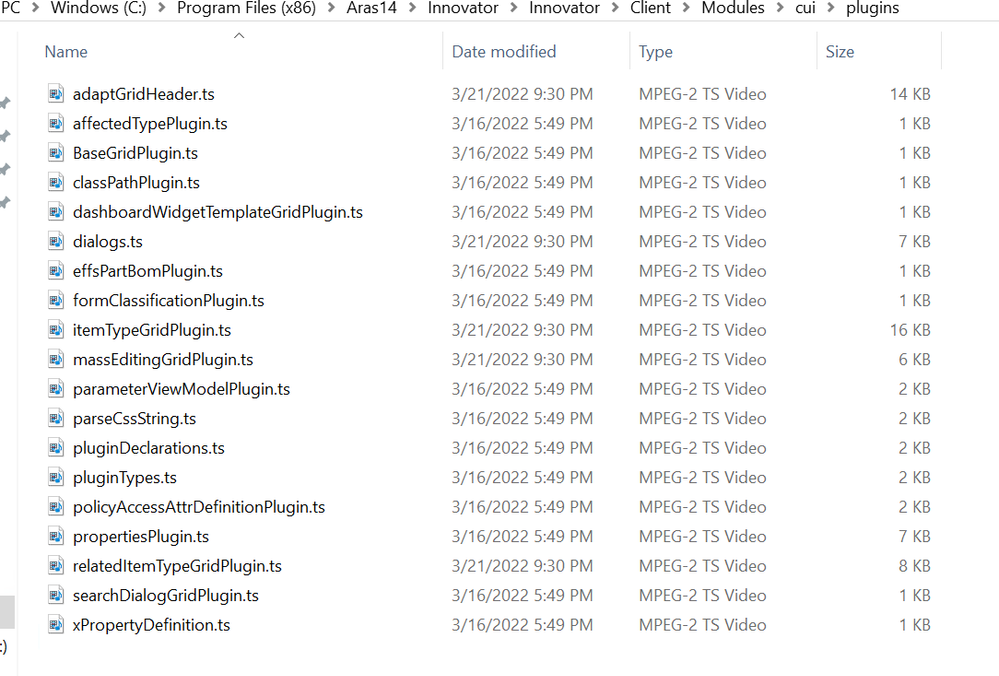

    3. Validate if there is any modification to this file \Aras\Innovator\Innovator\Client\Modules\cui\plugins\itemTypeGridPlugin

      3. I have checked the plugin folder , I dont see any code change difference

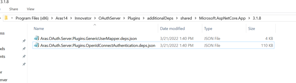

      4. Recently we have rolledout SSO (Single SignOn) through OpenIDConnect , we have used some plugins . I am not sure if it is conflict or override client folder. Let me share the screenshot of SSO plugin
      This is the only change done recently , that to oAuthServer folder, with new plugin
