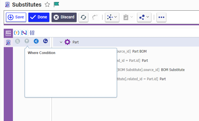

Silly question but, I don't see any obvious place to setup my report query with AML, only the graphics interface. Am I missing something?
- angela4 years agoCatalyst II
To be honest, I am not sure where to add this one. Somewhere in the beginning you specify the used ItemType and select the properties you want to display. You should be able to specify a filter somewhere.
I would add a filter for is_released=1 AND generation > 0 . And maybe "config_id is not null".
But I am just guessing. Better ask Aras support to get a more reliable answer!
