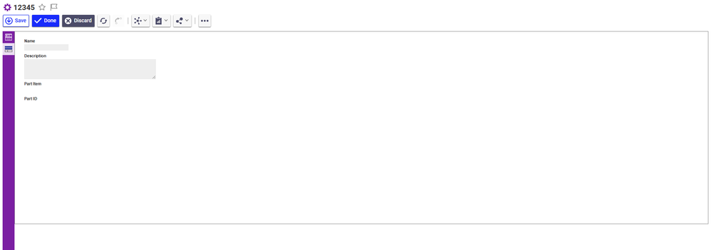

I am new to Aras, I was trying to load a Item instance of different itemtype into part.
I tried to follow sidebar_default_gv_click method and able to load the form. but the i am trying to load the item instance, which is not working.
Below is the Html Page which is loding the form in view only mode and if I try to change it into edit mode it dosent work.

Here I used item=null as aras.getItembyId(); is also not working.
can someone help me with using aras.uiShowItemInFrameEx(); method because it is loding the form and this is the method through which I think i will be able to load Item Instance.
Can anyone help me with how to load the form of diffrent itemtype through sidebar button?
  • You need to first retrieve the actual item using aras.getItemById("ItemType", "ItemID") and then pass the node of that item to the method. Replace item = null with something like const item = aras.getItemById("Part", "1234567890ABCDEF"); and then pass item.node as the second argument to aras.uiShowItemInFrameEx(). Make sure you have permission to access that item, and that it exists in the database.
