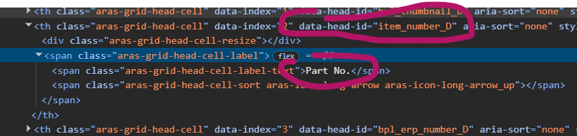

    I assume the use case is not easy to solve. You could probably replace the OOTB "Search" CUI button used for Parts with a custom one and do some additional JS tricks to change the labels. In the browser debugger you can see how property name and label are connected in the final table.
    Things will become interesting as soon as you have a language pack or people hide/unhide columns or use other search modes. And of course you have to reset the labels as soon no classification is used. In best case you can fetch the label names directly from the ItemType and don´t hardcode them in the code.
