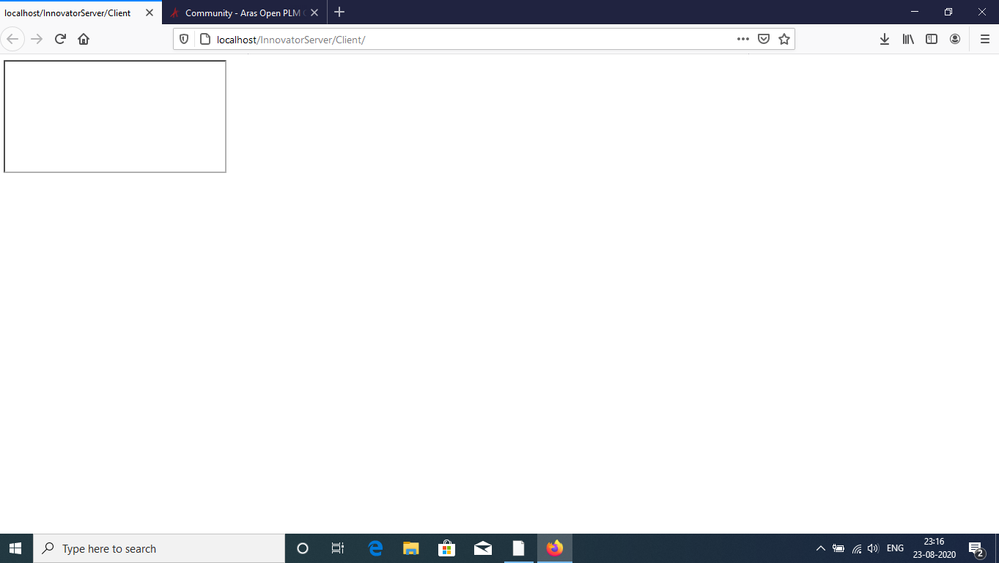

    I'm curious if you're getting any specific errors. It looks like you're using Firefox- if you right click somewhere in that page, you should have an "Inspect Element" option. Open that, then open the console tab. (You can also get here by hitting ctrl+shift+k.) Refresh the page, and look to see if anything shows up in the console.
    Just from looking at that box, I'm a little suspicious that javascript got disabled somehow, though when I try and replicate this I don't get the beveled box that you do. If other sites that use javascript are working for you, then it's probably not that.

      Dear Skyler,
      I have just installed Innovator and I am having exactly the same problem.

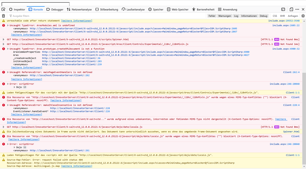

      You'll find a screenshot below. Unfortunatley, the console is in German, but most error messages seem to mention a MIME-type conflict or an unknown, missing or incorrect MIME type. I get similar errors in Firefox, Chrome and Edge.
      Do you have an idea about a possible reason for that error?

        Somehow reminds me to a problem with the German language pack that I faced too. Will your Innovator work when you switch browser language to English?

    • Gopikrishnan's avatar
      Gopikrishnan
      Accelerator II
      I faced similar issue and resolved after enabling the static content in IIS
      Ensure all necessary IIS components are installed. Go to Control Panel > Programs > Turn Windows features on or off, expand Internet Information Services, and enable:
      • Web Management Tools
      • World Wide Web Services
      • Common HTTP Features (e.g., Static Content)
      Restart your system after enabling these features.
