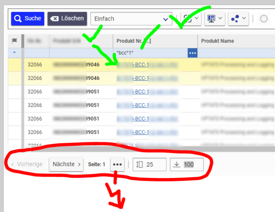

        My federated dataset with above sample project currently looks like this.
        Search bar works mostly like usual. Items are clickable. We can link the federated data to other items cause they have static id. But I still weren´t able to make all of the paging buttons work as normal. Especially the counter for amount of found pages and items is still missing. It´s not high priority, but it would be a nice addition.
