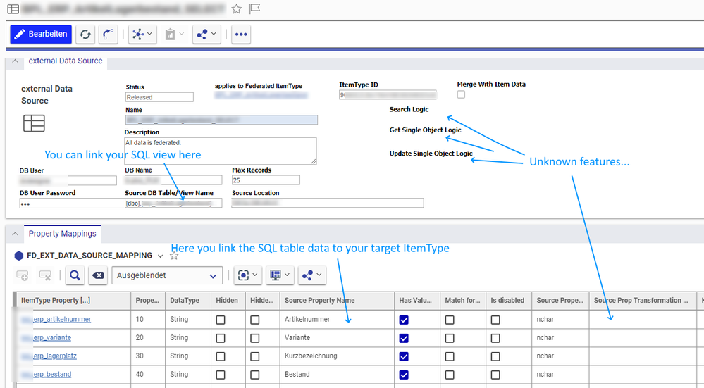

- Since a while they work on more advanced federation solutions. You can the Federation Service is on the roadmapHere´s a screenshot of the old sample project:
It´s a independent ItemType that you use in combination with a included generic “onGet” Method. It´s no big problem to remove the solution as soon there is a better one available.
I don´t use the project for all federation use cases. I have a custom variant that is optimized for speed and some others for add/update/delete.
I cannot send the package to you cause I don´t own this project. But I could send it back to Aras or share it with you when I got permission. It would be a big help to have the option to work with other users on this one.
