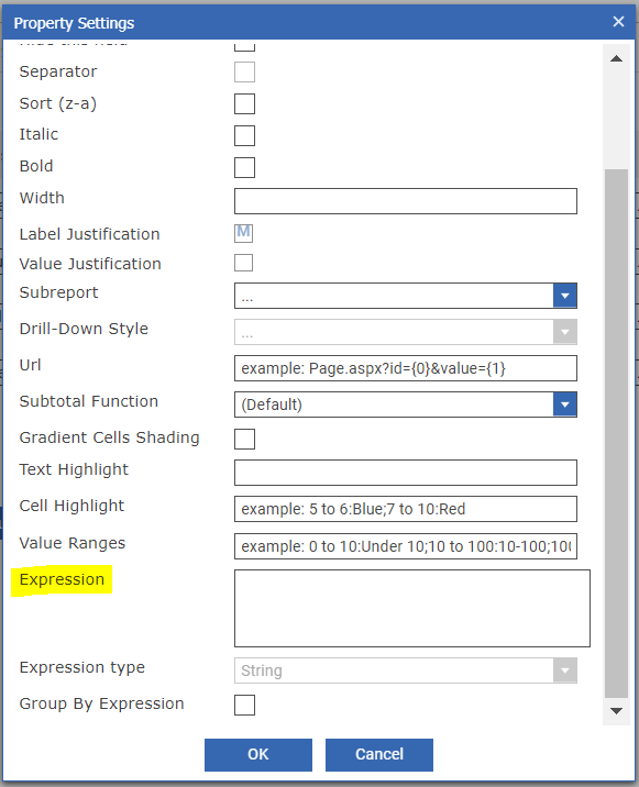

Hi All, I am trying to build a Basic report using SSRS.
I have a requirement where in I want to concatenate values of two Properties and show it in a single Column, Is that Possible using SSRS ?
Eg. the Item Type Name and Label should be displayed as "Name(Label)" in a single Column.
Will I be able to use the Expression Property to achieve the above use case ?

  • Got it !!!!!! For the above use case --> the expression name + ' ( ' + label + ' ) ' worked for me . It would be still helpful if someone could point me to the right documentation :)
      Hi Shruti,
      you can use the official documentation that also Aras use :-D. This report service is based on the 3rd-party "Izenda" report generator. Also Aras doesn´t support all Izenda features, you can reuse parts of the official documentation.
