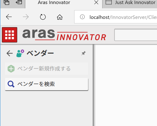

Hi team
We've started verification of ARAS innovator Ver12.0 build 13341 and add  ARAS packages from ARAS update.
But We cannot create some item due to the gray out.
Would you please good idea to resolve issue for us?

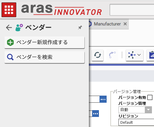

  • Dear Jayrajvh
    I refer to your advice and add identity for users, finally I can access "Vendor" item.

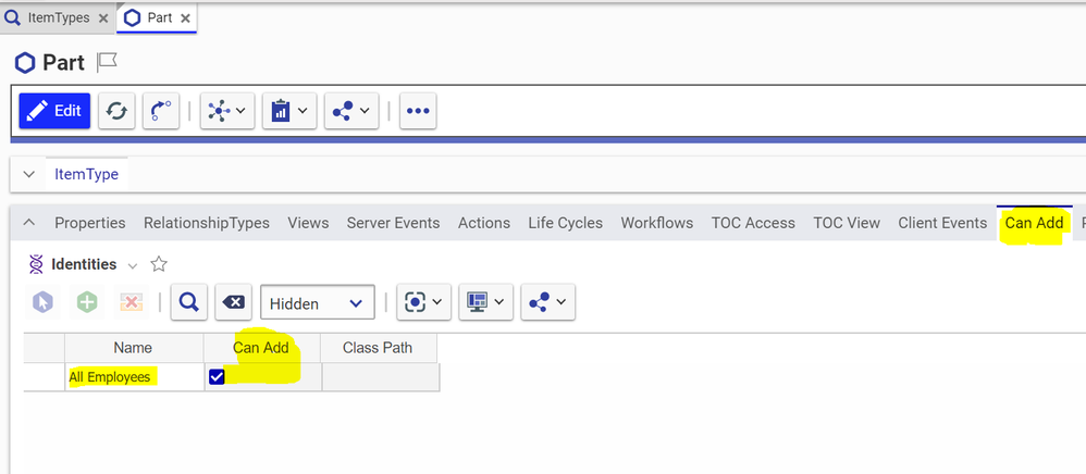

  • You need to have Can Add access to be able to create any ARAS Item. Can you check if you belong to Identity that has Cad Add access? You can refer below screenshot for checking CanAdd access on an item
