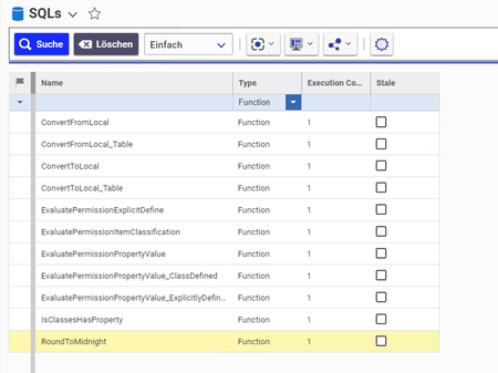

Hi community, inside Innovator the "SQL" ItemTypes contains some Procedures, Functions and other things used for internal purposes: It´s also possible to add own custom items. Common for example is the use of procedures that can be called e.g. this way: Item callframe = this.newItem("SQL","SQL PROCESS"); callframe.setProperty("name","update_has_files_flag"); callframe.setProperty("PROCESS","CALL"); callframe.setProperty("ARG1", source_it.getProperty("name")); callframe.setProperty("ARG2", source_id); callframe = callframe.apply(); In my case I want to store a pretty huge SQL query as function within the SQL ItemType. Unfortunately I don´t know how to call these kind of functions from my Method. Does any one has an idea how we can use Functions? Many thanks for your help! Angela1.6KViews0likes0CommentsVery large ItemTypes/tables in Innovator with SQL Express - what is your experience?
