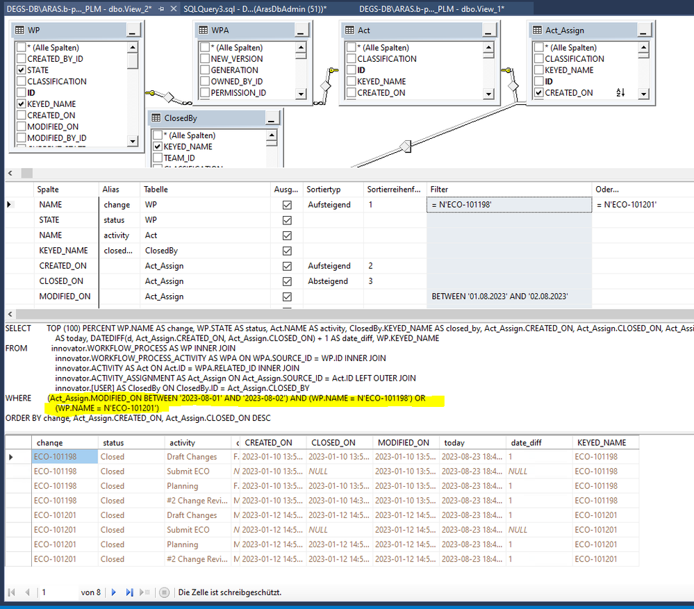

  • Edit: We are all blind!
    Take a look at my picture again. Do you notice something? I have added your BETWEEN date filter. Does the filter work? Yes...but NO! It´s uses the filter but with the date in a in wrong format, which can lead to all kind of wrong results. [I cannot remember ever having similar problems before whenever using dates....]
    Solution in my case: WHERE  (Act_Assign.MODIFIED_ON BETWEEN '20230801' AND '20230802')
    As alternative, something with convert(datetime,...) should also do the job.

        SSMS ist just the MS SQL Server Management Studio. I assumed you used it to build the query.
        Out of interest I made a quick test of the query. I had to remove one table that I don´t have, but the rest worked (in SSMS).
