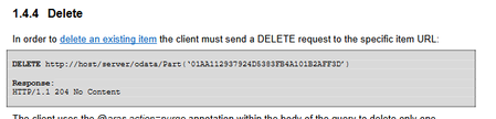

I tried to delete ItemType by following the Document about RESTful API in Aras. For example, PostMan was called as below (DELETE) localhost/.../exItemType ('abcde') If you call it url A 405.0 - Method Not Allowed error message is returned. Additionally, I tried to remove the RelationshipShip for itemType, but the same error occurred. Relationship remove was also carried out according to Document's method. For example, PostMan was called as below (DELETE) localhost/.../$ref This also returns an error of 405. How can I use RESTful to remove itemType?128Views0likes2CommentsIs there an "in" operator in the Aras REST API?
