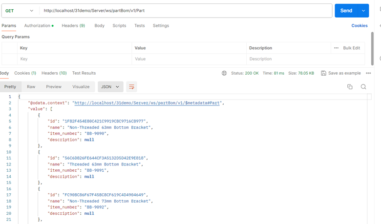

The format for querying your Web Service is exactly the same as using our OData endpoint. Using OData, a request for all parts looks like this:
http://localhost/31demo/Server/Odata/Part
Querying our new endpoint looks like this:
http://localhost/31demo/Server/ws/partBom/v1/Part
The URL you use is specific to your Endpoint, and of course, you can have multiple. You can find the URL in the Endpoints tab of your Web Service. It’s also important to note that you can use all the same tricks to get specific data that you can use in the OData endpoint.
Things like filtering, getting specific items, and querying relationships all work. Here’s an example of the part output.

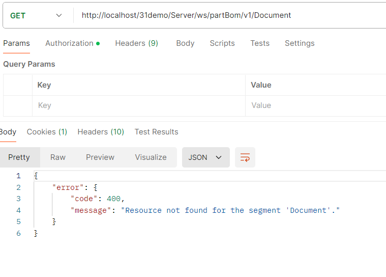

The only things that are returned from your query are the things you defined in your Web Service. If you try to get Documents without including them in your Endpoint, you’ll see the following result.
This is very powerful, allowing you to ensure that only the required data is exposed. A great example of this would be if you wanted to create an external application that queries Aras Innovator®. You’d want to limit the app's access to avoid potential security issues.
