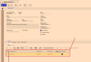

The Document's Type field had to be updated to a new value that was added to the list. Batch loader was used to the edit the Document but this created a new Version and the State to Preliminary from Released. We did not want the new versions to be created. The new version of these Documents were purged. Now, under these Documents all the files show as "Restricted" however, they are visible to Admins. How do I make these files visible again. Screenshot below263Views0likes3CommentsAllow a non-admin identity/user to "Unclaim" items locked or claimed by others

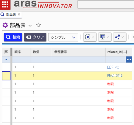

Hi, I'm facing new issue sharing the BOM with users. Users who has proper permission cannot see the part information as attached picture "Limited(Red)". Super user only can see the all item whether they are preliminary or released. Do you have any idea for this case? BR!1.3KViews0likes0CommentsInvisible product menu in the TOC

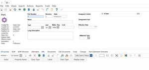

Hi Team I have configured extended properties for Part Item type and I'm able to select and add the xProperties in Part item using super user. But when I try to get / add xProperties using normal user, I was not able to get or add the xProperties. I'm getting the below error You have insufficient permissions to perform 'classify' operation for item id '46F261DDEDEA40F784EA2C51687BB519' by xClass id 'F4C365C728574ADEAE8EB1C4E5A50D25'. Attached screenshot as normal user and super user for reference. Do I need to add permission anywhere to see / add xProperties on Part as normal user ? Thank You6.1KViews1like2CommentsFile download error with message "user hasn't enough permissions for this file"
