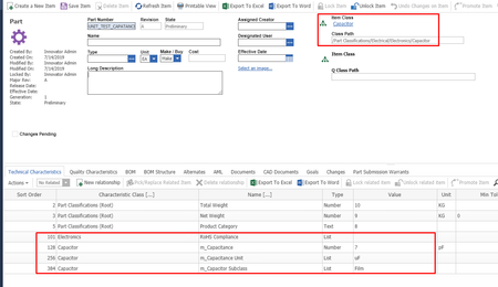

Hi everyone, As my picture above, I want to use AML to edit Part and set value Item Class, Class Path and some value like m_Capacitance Uni, etc. I'm just a newbie in Aras. So please help me or let me know some keywords to resovle this issue. Thanks a lot.Solved6.1KViews0likes2CommentsSearch Parameter with date time
