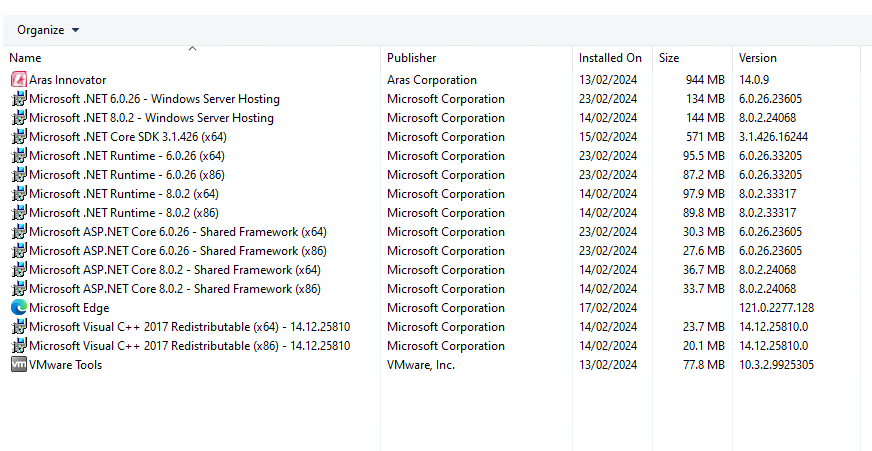

I have installed ARAS innovator 14.0.9 in our test environment (windows server) for users to test which will eventually deployed in production soon.

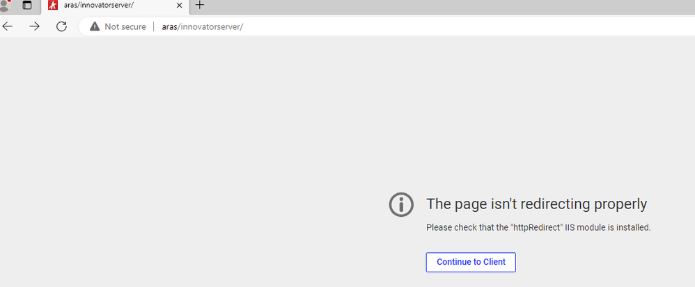

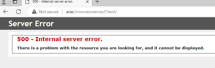

When I access http://aras/innovatorserver URL from the workstation, I receive error 'The Page isn't redirecting properly', when I click on 'Continue to client' then I get a 500- Internal server error.

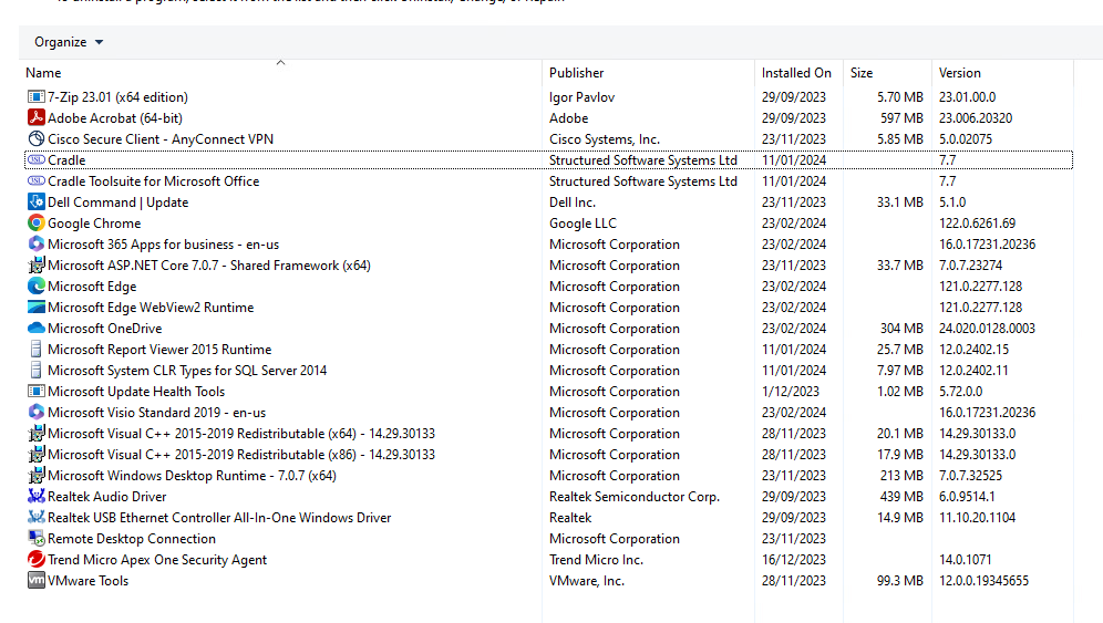

Attached are screenshots of programs and supporting apps on the server and workstation.

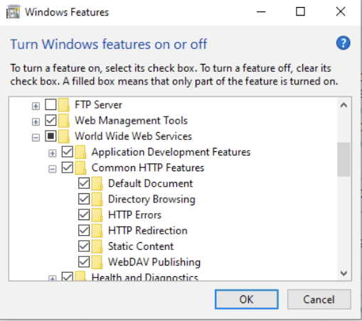

    Just a guess based on the error message but do you have the IIS component installed?   Under server and features Web Server IIS/ Web Server/Common HTTP Features/HTTP Redirection.
