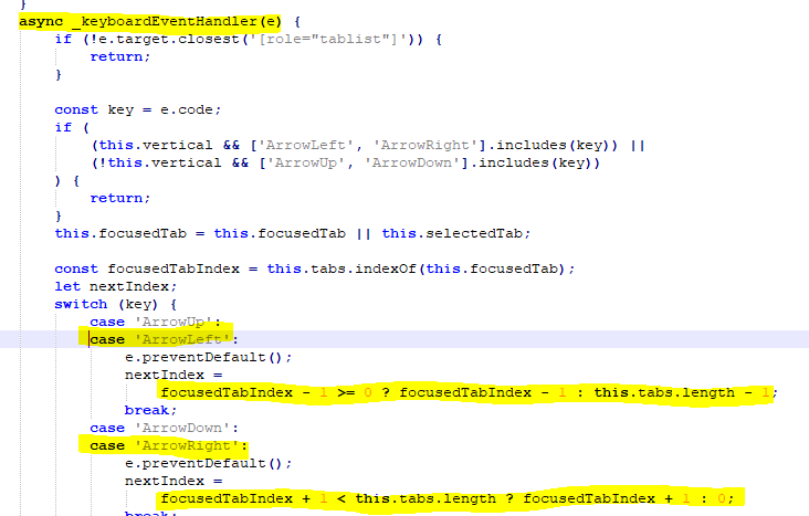

  • Hi community,
    I found something interesting in the codetree. The tab pane is rendered by Modules\compontents\tab.js.
    This file already contains functions for keydown events!
    There are now a couple of options:
    1. Keydown events to switch through tabs are available, but I don´t know which key combinations to use
    2. Keydown events are somekind of prepared inside Innovator, but haven´t been fully implemented yet.
    3. The shown code does something completely different and I am on the wrong track.
    Has anyone of you one of the latest Innovator version (15/16/17) up and running and can check if keyboard shortcuts work there?
    Best regards!
