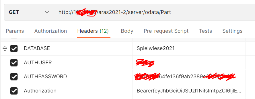

      Hi Christopher,
      i am getting the same error although i did an authentication. See the photo:

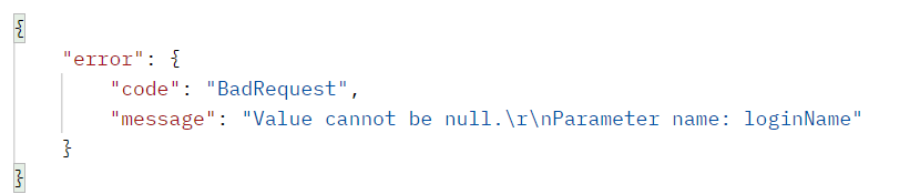

      Error is
      Can you help me with this?
