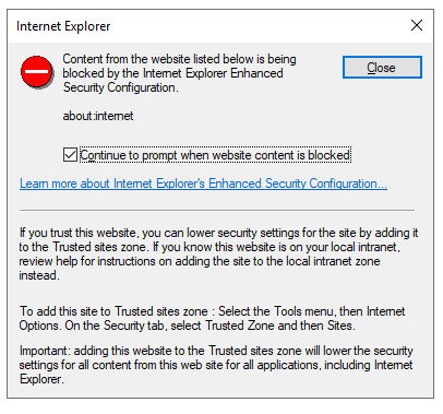

All I get is that the content is being blocked. Its in the 'Trusted Sites' but it still doesn't work... Tried Chrome, still not working, not sure what to do next... Any idea what settings might fix this?

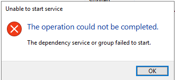

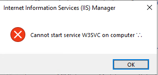

Ugh I'm back to this other terrible error, it won't start up IIS
The internet just says restart the service, but it fails
The only way to get IIS to start up again is to delete everything under 'default web site', something is wrong there.
Any help would be gladly appreciated

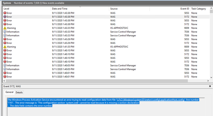

    Here is the error
    The Windows Process Activation Service encountered an error trying to read configuration data from file '\\?\C:\Windows\system32\inetsrv\config\applicationHost.config', line number '1161'. The error message is: 'The configuration section 'system.web' cannot be read because it is missing a section declaration
    '. The data field contains the error number.

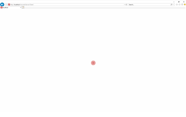

    Now it gives me fun circle that never loads. How do I resolve this?

      This is the error

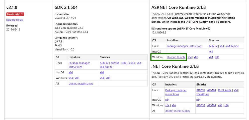

        Wow did I do a lot of unnecessary stuff. Figured it out, it was that the instructions didn't accurately explain WHICH .net core link to install. I installed the SDK, not the 'hosting bundle', it HAS to be the hosting bundle
