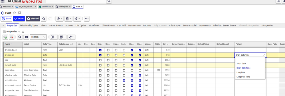

Hi All,
I got an assignment to change the date to universal date format across ARAS environment as below.
FormatTime formatComment
Date: . YYYY-MM-DD
Eg. 2025/12/05
Date: . YYYY-MM-DDThh:mm:ssZ
Eg. 2025-12-0502:01:15 PM
12-hour formatIncludes AM/PM
Please help where to change this.
  • Interesting topic.. In general we also faced with this issue. what we 've found out is - Aras inherits your browser settings and strictly depends on the browser language if you have localization set to "English(US)" then you'll have mm-dd-yyyy settings, if e.g. English (Uk) - then dd-mm-yyyy. So if you have a possibility to modify this setting on the company level, it will work.. We just create an instruction and users can make this change ourselves.
    Also you'll need to revise what date pattern is used, and adjust if needed.
    Hopefully there's a more reliable solution to this task.. I don't really like how we handle it. So looking forward to seeing some other answers to this topic
    Best regards, Maksym Archybasov
