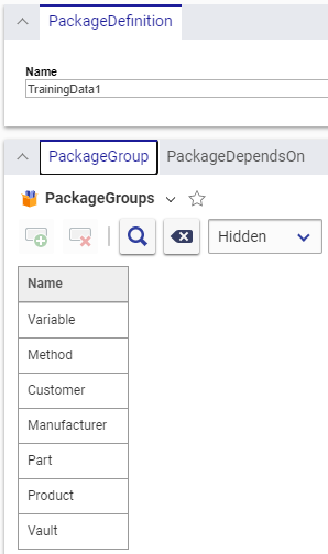

I'm creating a demo environment and want to export the new Part definitions and Forms that I have created. When I try to add Part or Form to my new package, I get
   Unable to add item Form PackageElement (PackageElement) with Element Id '47573682FB7549F59ADECD4BFE04F1DE' already exists.
Both part and form already exist in com.aras.innovator.solution.PLM, which I would have expected to use in the "Depends on" section.
I can use this PLM package and remove all the other item types and then export, but it would be more convenient to just use my custom package. This seems to be possible as seen in the packages for the aras training here. This includes what I want and more:
How do I achieve this?
