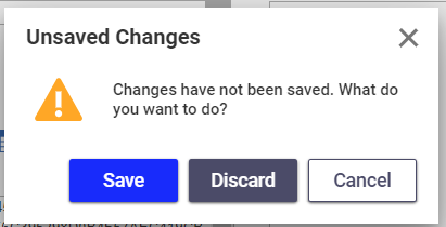

Without editing item getting unsaved changes warning
When I open an item of the Custom item type from the search grid and attempt to close it without editing the item, Aras displays an unsaved changes warning.
