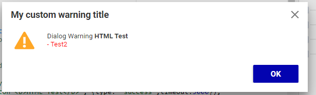

I made various dialog tests and noticed that standard "alerts" allow us to use html with custom styling inside the text.

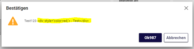

This is how the similar message would look like in the confirm dialog. Note that is just will show the plain html.
