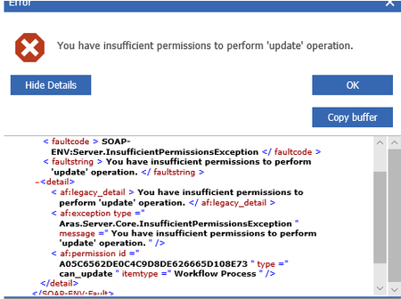

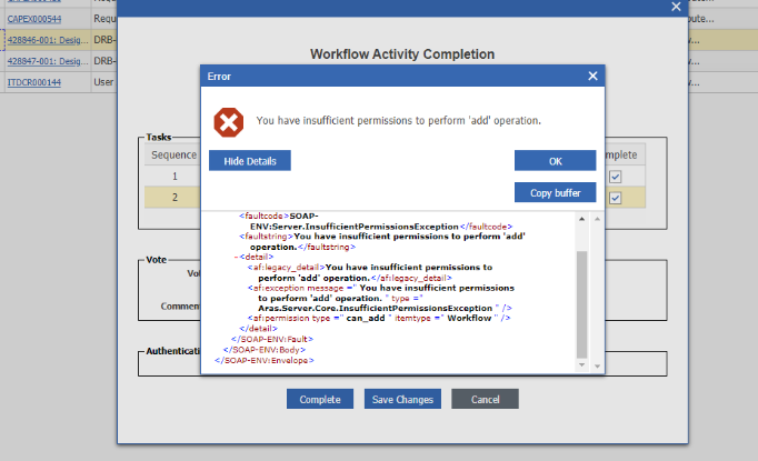

Hi Nathan,
There is another similar issue that am facing . Pls ref the error msg below,
This is also occurs while voting to DAB Activity from DRB activity. I added the identity group in workflow process of that part and gave update and other necessary access permissions. But still user couldn't vote for that activity and same error occurs. Lifecycle state permissions of the subworkflows DRB and DAB are also added with those group identities and given update permissions.
What am i missing here? Please advice.

- Nathan6 years agoCreator III
Bala,
This is an odd error. My first thought was to check the Can Add section of the ItemType, but my understanding is that is only to add a new item. I would check it anyway. Check the Life Cycle Map permissions for each state of the Life Cycle. It could be that the people trying to do this are not in the State Permissions group. Another thing to check would be any methods that are being used by the Life Cycle, Workflow, or the ItemType. There could be something in the method that is causing the problem. Sorry I couldn't be of more help.
