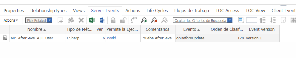

I want to schedule an event that when the data is saved, save option, make me a count and update the form. I have created the onAfterUpdate event on the ItemType i tried  too onBeforeUpdate and the same.

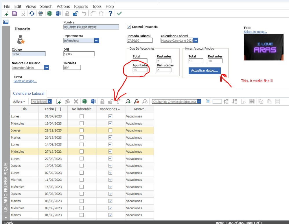

I have a display (ItemType), with a related table. In this table they choose the vacation days of the year and when saving, I put an event so that it makes the sum of the chosen days and updates the corresponding ItemType attribute.

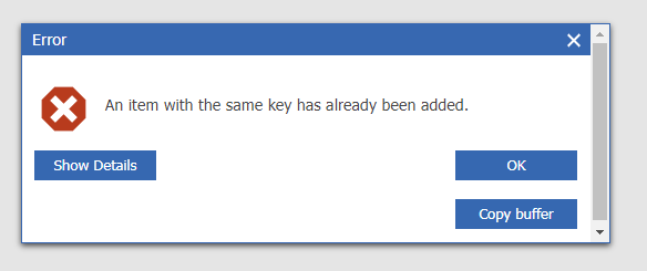

I have tried it by AML code, but it gives me this error, I suppose that on the server side, it does not allow an edit to be made to a table in edition.
CodigoAML = "<Item type='AIT User' action='edit' where=\"id = \'"+sourceID+"\'\"><mp_dias_vac_restantes>"+vacDiasRestantes+"</mp_dias_vac_restantes><mp_dias_vac_apuntadas>"+vac_DiasApuntados+"</mp_dias_vac_apuntadas><mp_dias_vac_disfrutadas>"+vac_DiasDisfrutados+"</mp_dias_vac_disfrutadas></Item>";
var ResultadoEdit = innovator.applyAML("<AML>" + CodigoAML + "</AML>");
I get this error:

  • You don't need (and it's not allowed, so you get error) an additional update in the onBeforeUpdate method. Just change the properties of "this".
    [embed:dc8ab71f-3b98-42d9-b0f6-e21e02a0f8e2:85f947e1-db8b-4ac3-9e72-db466925afe3:type=csharp&text=this.setProperty%28%22mp_dias_vac_restantes%22%2C%20vacDiasRestantes%29%3B%0D%0Athis.setProperty%28%22mp_dias_vac_apuntadas%22%2C%20vac_DiasApuntados%29%3B%0D%0Athis.setProperty%28%22mp_dias_vac_disfrutadas%22%2C%20vac_DiasDisfrutados%29%3B%0D%0Areturn%20this%3B]
    And more likely you need link you method to onBeforeAdd too.

      Yes!!, its works!!!!. Thanks.
       Now the problem is that when executing the method before saving the related table, the one below. Since the changes are not saved, they are not applied to the summation. If I press the save button twice, the second time it already applies the changes. Which is logical since the data is not yet saved.
