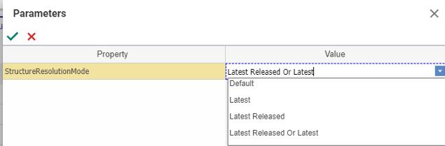

Hello community, I'm trying to filter my tree grid on my part and my part bom with the structureresolutionmode parameter in my query definition (child/parent), but nothing happens. I'm at the aras 22, I followed the builder's guide with the notion of parent/child join.

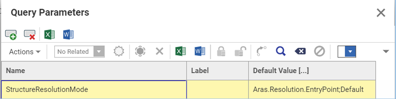

I created the parameters in the query definition and in the tree grid as well as in the qry_QueryDefinition

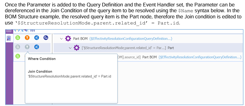

In the constructor guide "Reference to the parameter in the join condition in the query" case of a child-parent relationship
Here is an example of how to define my query, what condition should I put to apply my resolution structure to all my elements. Thank you I hope I have been precise not easy when you start.
