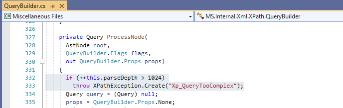

The xpath query is too complex
I am experimenting with Federated data and am getting the error "The xpath query is too complex".

    "The xpath query is too complex" is a common error when using "appendItem()". There is a maximum number of items you can append to an item (collection), before this error gets thrown (I forget how high that number was, maybe somewhere around 2000?). You can work around this by looping at most, say, 1500 times, then applying, and then continuing to loop over a now freshly empty collection.
