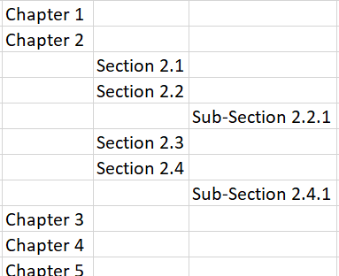

Thank you once again.
1. Yes, my document structure consists of Chapter -> Section -> Sub-Section -> Sub-Section.
2. In addition to above, I use Chapters and sections on parallel levels as well (Ex: please see below)
3. Yes, I use TOC only and I have no problem with that.
Please note that here, I am saving Chapter 1 as separate external content, Chapter 2 as separate, Section 2.1 as separate, Sub-Section 2.2.1 as separate content and so on.
When I try to build my document by using add-> External content with all these individual chapter, section and sub-section contents, first I insert chapter 1.It comes by default as Chapter 1.
Next I go and add->External content and insert Chapter 2, this time am getting numbering as 1 again.
After this I want to add Section 2.1 underneath it which I am not able to do (since when I add external content for Section 2.1, it again goes with numbering 1).
