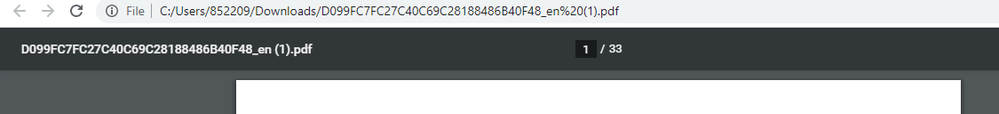

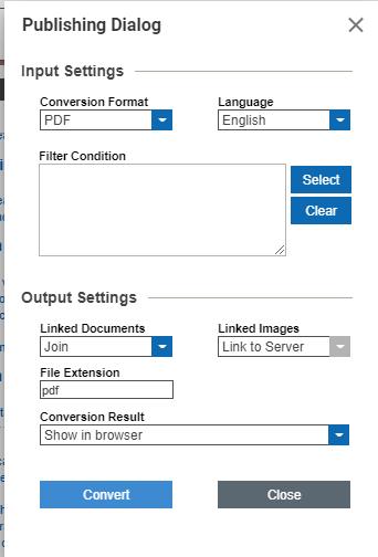

When we are trying to publish technical document in PDF format, after publishing it generates document and gets downloaded. Please find the attached screenshots
We have noticed that instead of Filename, it is having ID. Is it possible to change naming convention i.e instead of ID, can I publish tech doc with tech doc name as file name?
Any customizations required? or should we have to change existing code methods? Kindly suggest.
Thanks,
Sowmya
  • Hello Sowmya, here is the answer,
    First access method called "tp_PublishingDialogAPI",
    Please add below two lines of code after line no :432
    var FileName1=fileName+".pdf"
    var downloadResult = aras.downloadFile(fileNode,FileName1);
