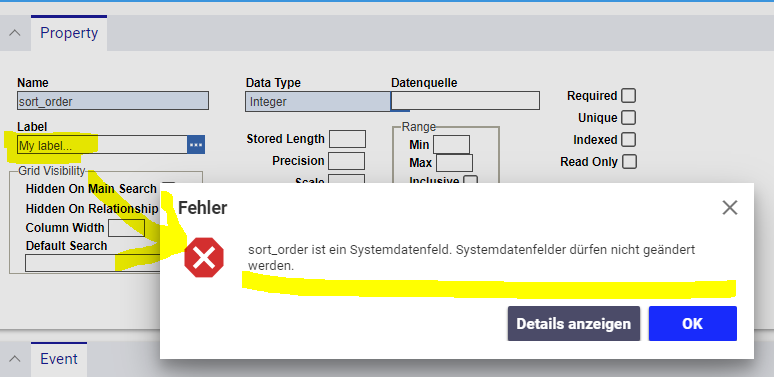

sort_order is a system data field. System data fields must not be changed
Hi community,
I try to change the label of the sort_order property in one of my relationship ItemTypes.
I have done this kind of change in many ItemTypes before and it always worked as expected. Typically I replace the sort_order label with something more readable for the user.
But in my current sort_order property, I literally can change nothing, not even the label. I always get the following error message:
I even get the error message if I don´t change anything and just click "save". In every other ItemType, changing the sort_order property works without trouble. But my current ItemTypes just won´t let me do it.
What can be the reason for this behavior? How does Innovator decide if a property is a system property?
On SQL the shown "sort_order" looks like all the other "sort_order" properties in the database. I don´t see anything difference to all the other sort_order entries.
It really would be a big help if someone has an idea what can cause this behavior!
Many thanks in advance!
  • I so far haven´t find the root cause for this one. I ended up manipulating the property directly in SQL which worked for setting a custom label.
    But if anyone has an idea, please let me know!
