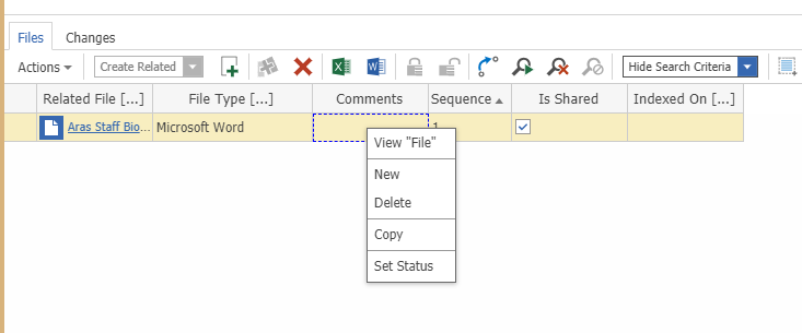

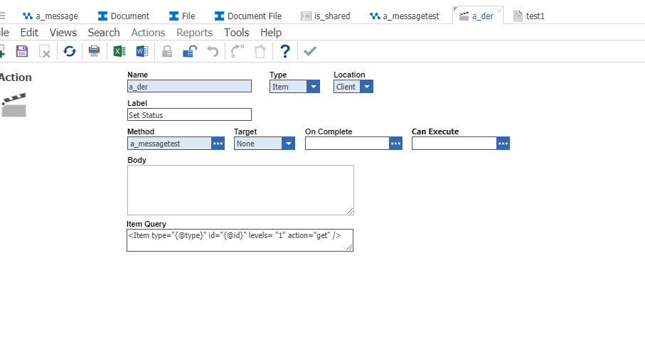

Hi all, I am currently trying to setStatus from an action. The status would be set after I right click and select the action from the relationship grid.
var statusId = aras.setStatus('Downloading.....', '../images/Progress.gif');
return this;
For some reason the status is not being updated accordingly and this is happening only when the method is attached to the action.
