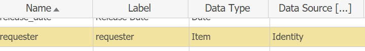

The Item DLV_PPS property looks as follow:
Any idea, why it doesn't work?
