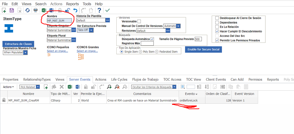

    I have a server side event. in the onBeforeLock event.
    Basically, I want to create an RM (itemtype ProdRef), but first I want to check that there isn't already one linked to another field of the itemtype.
    The funny thing is that it executes all the code and then gives me the error message.

    • alaxala's avatar
      alaxala
      Creator III
      What ItemType is your onBeforeLock event linked to?
