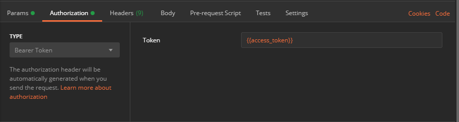

In PostMan obtain a token (not covered here) and add new "POST" request that will use it in Authorization tab:
Point to your server and tack-on /server/odata/method._Hello_Word:
You should see a return of "Hello World".
