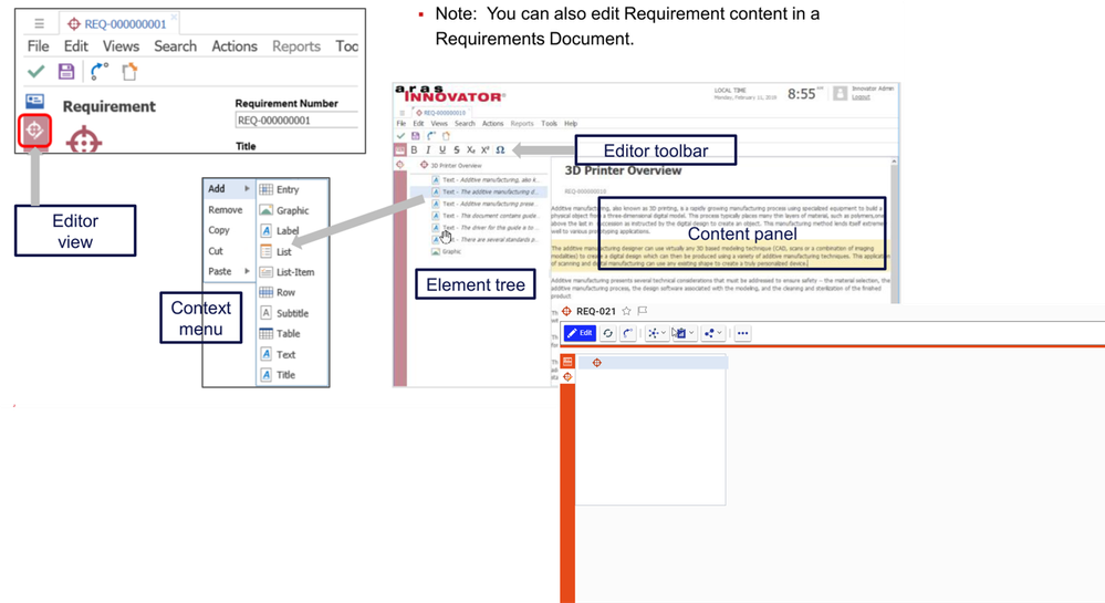

Everything open fine. It's just the editor that has lost all functionality. When opening a requirement, you see the standard form. But when you change to the editor, nothing shows. It switches the layout as if it tries to show but there is nothing there.
Hence I thought that if I switch back the properties to the original the functionality would return.
Is there anyway to revert to "out-of-the-box" regarding itemTypes (like a system restore of hte itemType)
- angela5 years agoCatalyst II
Sounds like the Form field has lost connection to the properties. Edit your Form and click the individual fields. If they don´t have a "Data Source" than this is your error.
Also take a look of the assigned Forms to the main RM itemtype. If there is no "Default" form, than also these kind of strange views can happen.
You can reimport the RM solution to fix the issue. It´s possible to just import the affected elements. But I assume your problem should be easy to fix.
See this incident as perfect reason to get your self a test system or at least use a secondary test database. :D- Xel3215 years agoIdeator III
Is it really the form?
Cause the form is the other part but as you se in the pic below to the right, the edtior is not loading correctly.
